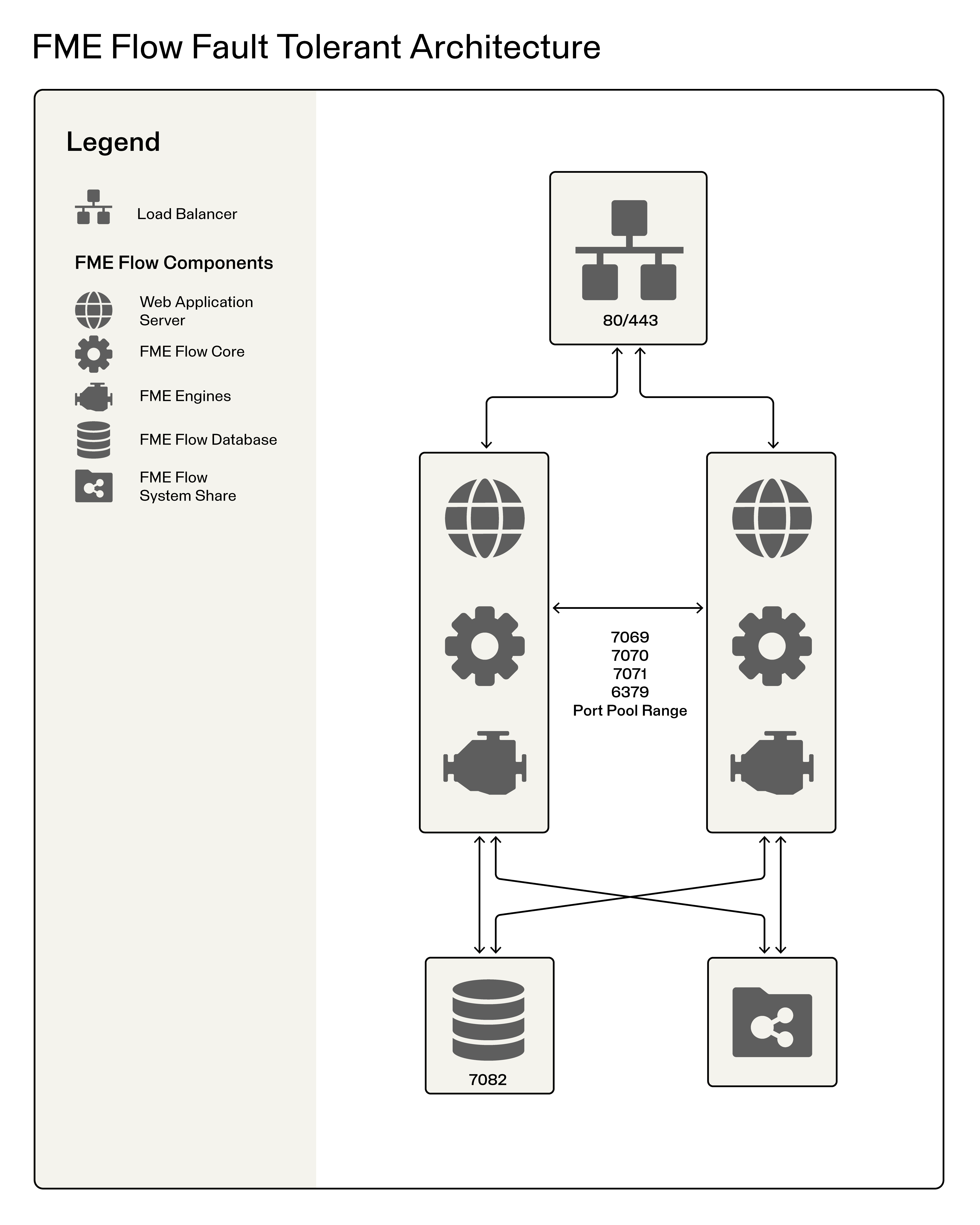

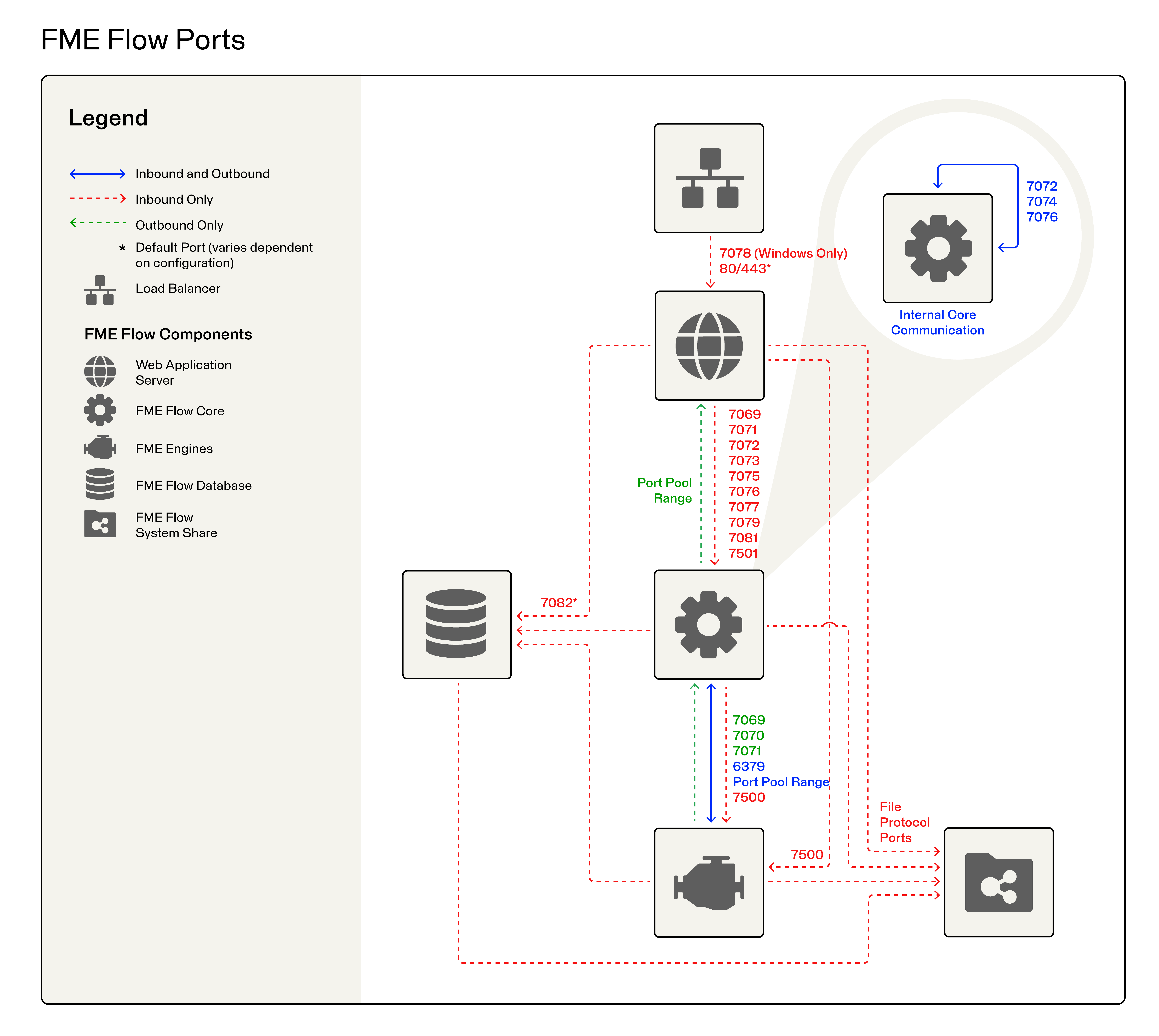

Diagrams of FME Flow Ports
Mouse-over for diagrams:
FME FlowPorts |
FME Flow Ports Specific to a Fault-Tolerant Architecture |
Defining an Ephemeral Port Range
