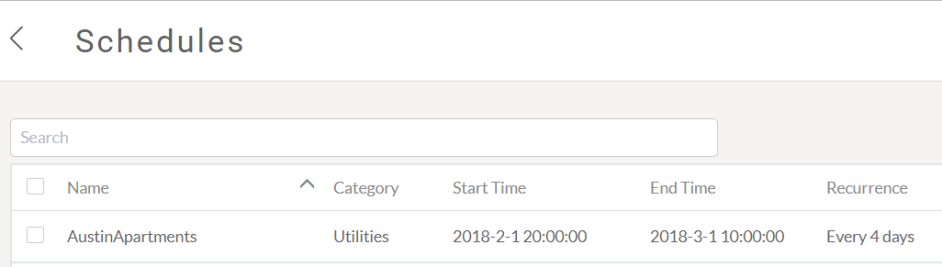

The Schedules page allows you to run workspaces at specific times in the future on a repeating or non-repeating basis.
A request to run a workspace at a scheduled time is called a task. Each entry in the Schedules table represents a scheduled task. When a task is completed, its entry is removed from the table when the page is refreshed.

The columns displayed on the Schedules page are:
Note  Some fields do not display by default. To control which columns display, click the Customize Columns icon.
  • Name: The user-defined name of the task.
  • Tags: The tags assigned to the schedule.
  • Start Time: The time at which the task is scheduled to start, using the following syntax:
  • year-month-day hour:minute:second
  • End Time: The time at which the task is to end. The time displays as N/A if the task does not end, or using the following syntax:
  • Recurrence: The frequency of the task. Recurrence displays as, Never (if the task occurs only once), a Cron expression, or the recurrence interval, whichever is specified.
  • Note  cron expressions display according to the time zone of the FME Flow that is running the task. All other times display in your local time zone.
  • Workspace: The workspace that runs the request.
  • Status: The current status of the task.
