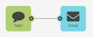

  • (Preferred) In an Automations workflow that is initiated by an FME Flow Topic trigger.
  • For example, this workflow can deliver an email whenever the DATADOWNLOAD_ASYNC_JOB_FAILURE topic is notified:
