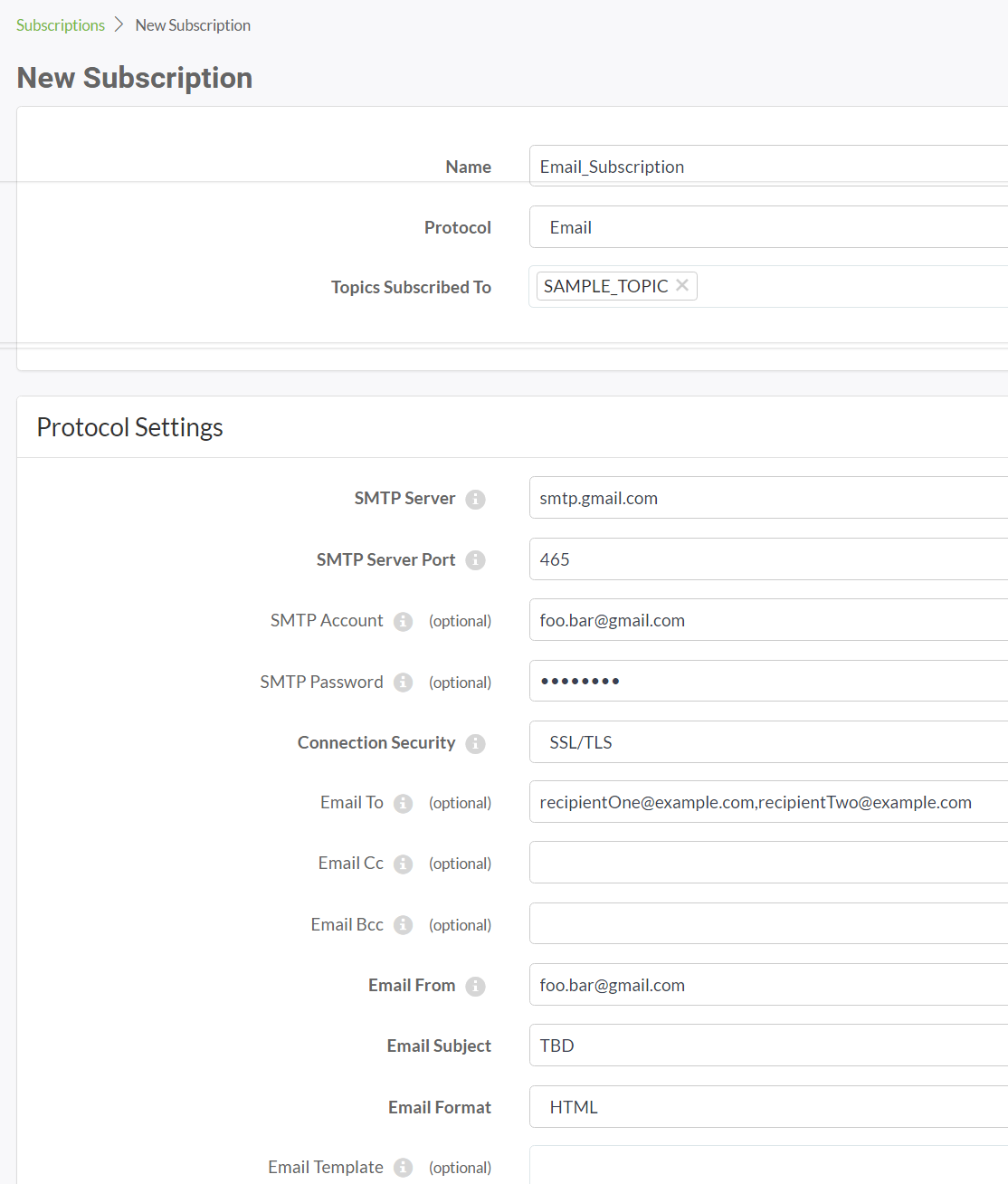

Example
Mouse-over to see the full image:
