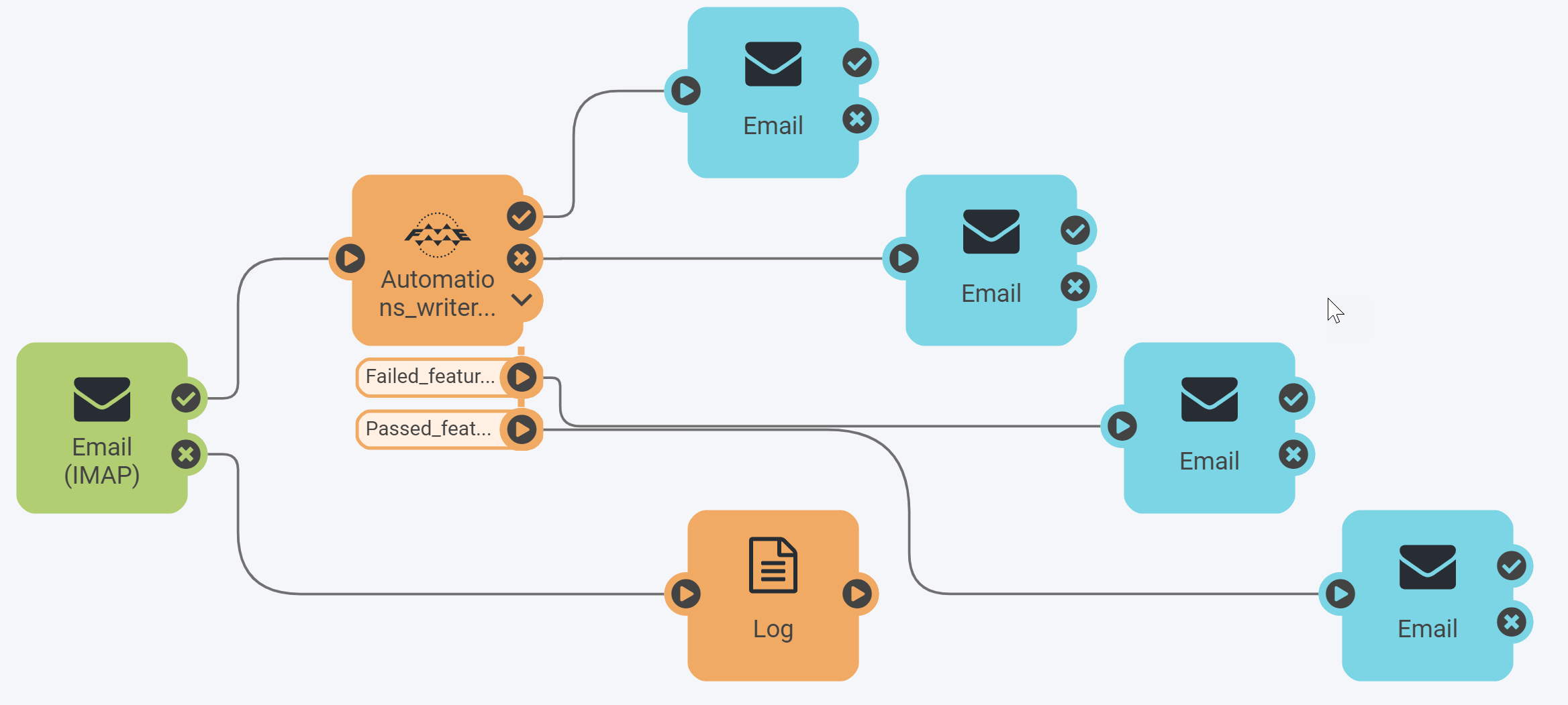

The example below illustrates a simple workflow comprised of a trigger that receives an email, an action to run a workspace, and an array of external actions that sends emails depending on the workspace results. An Email Received (IMAP) trigger sends messages to a Run Workspace action whenever an email from a specified IMAP server host is received. The workspace validates features in a file attached to the email, and reads features that pass validation into a database. The automation proceeds with separate Send an Email external actions based on the results of the validation in the Run Workspace action. One email sends details about features that passed validation and were read into the database, including details on feature type attributes. Another email sends details about features that failed validation. As well, two additional emails are sent depending on whether the workspace completed successfully or not. Finally, metadata about any Email Received triggers that fail to fetch emails is logged.
Mouse-over to view:

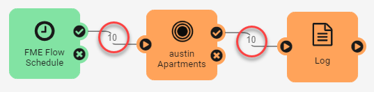

To view event counts
FME Flow records the number of times a node in your automation runs. Event counts are visible on connection lines. In this example, both the FME Flow Schedule trigger and the Run a Workspace action have run ten times since the automation started:
Event counts automatically refresh every ten seconds. To expedite a refresh, click Refresh.
Once an automation is stopped, the final event counts display. These final counts are removed and reset when any of the following occurs:
