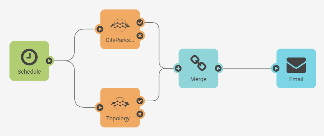

Use the Merge Messages action to combine messages before proceeding with a workflow. This example merges the messages from two FME Form workspaces before sending an email. The combined message does not arrive at the Email external action until both workspaces have successfully completed.
