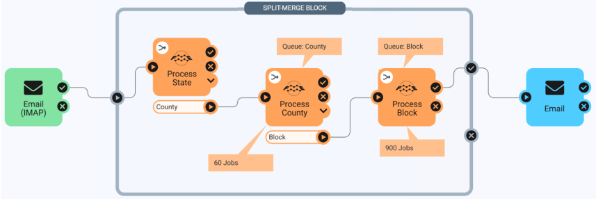

This example sends an email after a set of workspaces completes. A split-merge block receives a message from an Email Received (IMAP) trigger. The block comprises three Run a Workspace actions. Workspace Process State runs one job and outputs county feature type data to workspace Process County. The Run a Workspace action for Process County runs 60 jobs (one for each county), and outputs block feature type data to workspace Process Block, which, in turn, runs 900 jobs (one for each block). The block waits to ensure that all 961 jobs are complete before it outputs a single message to a Send an Email external action.

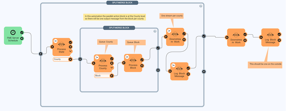

You can nest split-merge blocks inside one another to control the level by which you want to aggregate output messages from workspace actions. This example nests the Process County and Process Block workspaces from the previous example inside another split-merge block that initiates with workspace Process State. By nesting in this manner, messages are aggregated at the county level for processing, rather than the state level, before being output as a single message. The nested split-merge block outputs one message for each county, combining all of a county's block data. Each message is input to the workspace actions in the outer split-merge block for processing. When complete, a single, combined message is output from the outer split-merge block.
