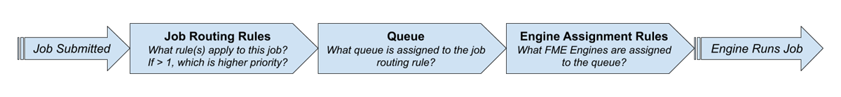

How It Works
Queue control is configured through three mechanisms that work together to ensure the right engines run your jobs.
- Job Routing Rules: The criteria for a job to meet in order to qualify for a specific queue. Criteria can be based on performance metrics of workspaces, which are reported on the Workspaces page. Or, the criteria can be based on other properties of workspaces, such as name or repository.
- Engine Assignment Rules: The assignment of engines to queues based on properties of engines or queues. Alternatively, engines can be assigned to queues by engine name. Optionally, with Active Periods, engine assignment rules can apply only at specified times.
- Queues: The FME Flow mechanism that holds jobs and routes them to engines based on job routing and engine assignment rules.
