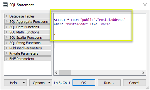

In this example, we will create a set of features by querying a PostGIS database, which has a table containing addresses with point geometry. We will use a SELECT statement that extracts a subset of the data based on postal code.
A SQLCreator is placed in the workspace.
In the parameters dialog, the Database Connection is selected (or defined, if not previously saved).
A SQL statement is constructed in the SQL Statement parameter, using the built-in editor. The syntax matches the database being used.
There is a convenient shortcut in the editor - by right-clicking on a table (or column) name under Database Tables, you can create a quick statement based on SELECT and more to start editing from.
In this case, we are selecting all of the records in the PostalAddress table that have a postal code starting with V6E.
By default, the output has hidden attributes. Choose the ones you wish to include in the Attributes to Expose parameter.
The query results are extracted, including geometry.
