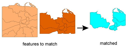

The Matcher can receive any number of input feature streams. All features are compared against all other features, and matches are identified based on the parameters defined.
Options for matching include geometry and/or attributes, and you may also define attributes that must differ.
All features that find a match are output via the Matched port (that is, if two features match each other, both of them are output here). Each set of matches is given a new numeric Match ID attribute that can be used to identify them as a matching group.
A single copy of each set of matched features is sent to the SingleMatched port. The attributes on these features are merged on to one output feature. Using this port, the Matcher is capable of doing multi-feature merging using geometry as the key. This complements the FeatureMerger, which only accepts attributes, and not geometries, as keys.
Features that do not find a match are output via the NotMatched port.

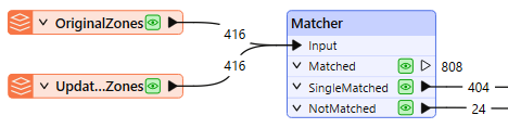

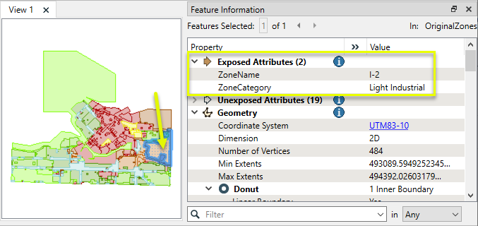

In this example, we have two copies of a zoning dataset. One of them has been updated, with changes made to some zone attributes. The polygons do not have a unique ID that could be used to do a comparison to find the updated zones, so we need to use geometry matching.
Both the original and updated datasets are routed into a Matcher.

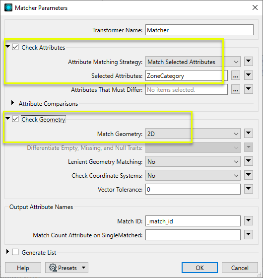

Match Geometry is set to 2D, and the Attribute Matching Strategy is Match Selected Attributes. We select ZoneCategory as the attribute to compare. This will find polygons that have matching geometry, and check whether or not the attribute has been changed.

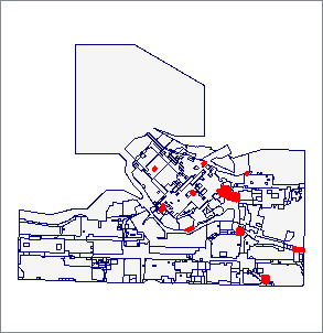

One copy of the polygons that matched are output via the SingleMatched output port. These are the records that were not altered, shown below in blue.
Records that were altered would not encounter a match - though the geometry is the same, the attribute we specified is not. These features are output via the NotMatched port, shown here in red.
