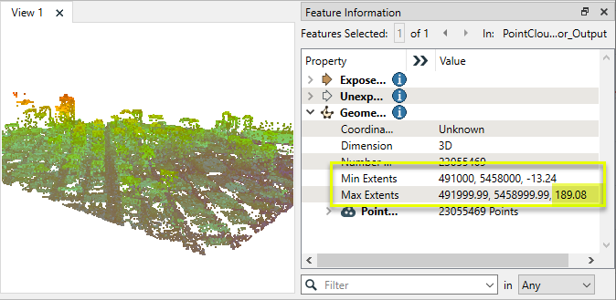

In this example, we start with the same LiDAR dataset as the previous example. Note the display coloring as shown in the FME Data Inspector, which renders point clouds that do not have color components using a rainbow gradient. Blue represents the lowest points, moving through the spectrum to red at the highest points.
This point cloud is shown as predominantly blue - an indication that there may be some high, invalid points that should be removed.
Note that the Max Extents z value is 447.
Examining the tops of the tallest structures, the highest valid z values appear to be less than 200.
The point cloud is routed first into a PointCloudFilter, and then on to a PointCloudPropertyExtractor.
In the PointCloudFilter parameters dialog, one expression is created, sending all points with a z value of less than 200 to the GoodPoints output port.
In the PointCloudPropertyExtractor parameters dialog, Calculate and Update Extents is set to Yes.
Note that the x, y, and z component minimum and maximum values will also be extracted.
The output point cloud feature reflects a more even color gradient distribution.
The newly calculated maximum z value is 189.08.
