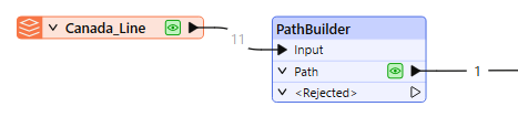

In this example, a transit line is represented by a number of line segments, each approximately 1,000 meters in length, with varying numbers of coordinates per segment.
We want to combine these into a single geometry but keep the segment information intact.
The features are routed into a PathBuilder.
In the parameters dialog, the default settings are kept.
One feature is output with Path geometry. Note that the original segments are intact within the path and could be recreated using a PathSplitter.
