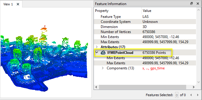

Note that the source dataset has over 6 million points in it. Viewed here in the FME Data Inspector at an oblique angle, we can see that it contains a number of tall structures in a fairly flat area.

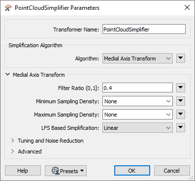

In the parameters dialog, the default settings are kept.

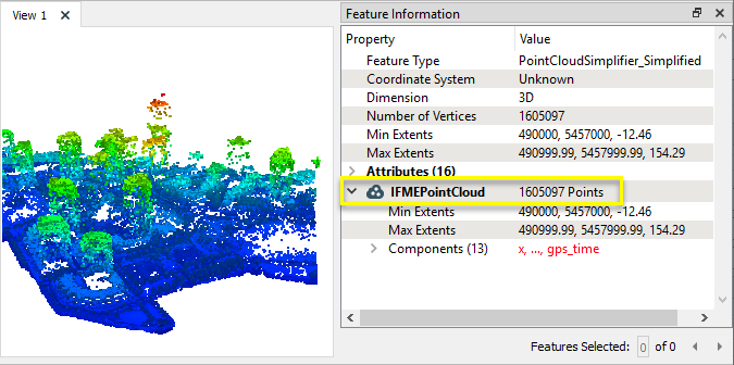

The output point cloud has been reduced to just over 1.6 million points. Note that areas with rapid elevation change - the structures - remain largely intact, whereas large flat areas with little change in elevation have been thinned much more aggressively.

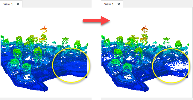

Compare the point cloud before and after simplification:
