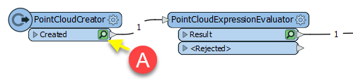

In this example, we will create a point cloud for testing purposes, enabling us to run and test a workspace before the actual data is available. A PointCloudCreator is added to the workspace, and feature caching (A) allows us to view the point cloud as it exits the transformer.

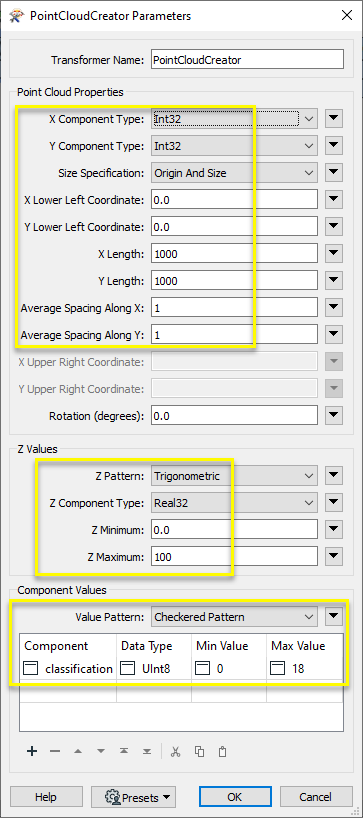

In the parameters dialog, we define the size of the point cloud by choosing Size Specification > Origin and Size.
Both the X and Y Component Types are Int32 (32-bit integers), and the X Length and Y Length are set to 1000, with Average Spacing (for points) along both axes as 1. The origin is 0,0 as defined by the X and Y Lower Left Coordinates.
Z values will be created in a Trigonometric pattern, and so the Z Component Type must be floating-point. Real32 is selected. The values will range between the Z Minimum and Z Maximum values of 0 and 100.
One component is added, classification, and its values will range from 0 to 18 in a Checkered Pattern.
These Z Values and Component Values selections will provide a range of values to test against in the workspace.

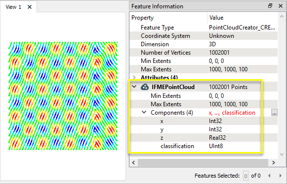

A point cloud feature is output as specified, and is passed along to the next transformer and can now be used in the workspace.

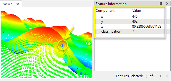

Viewing the feature from an oblique angle in the FME Data Inspector, note that the individual points have z and classification values interpolated between the specified minimum and maximum values.
