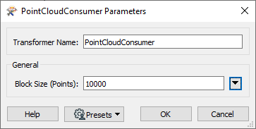

In the parameters dialog, we keep the default settings.

Block Size (Points) |
The point cloud will be consumed in blocks, reading this many points in each block. Adjusting this parameter is generally only useful for internal Safe testing. |
