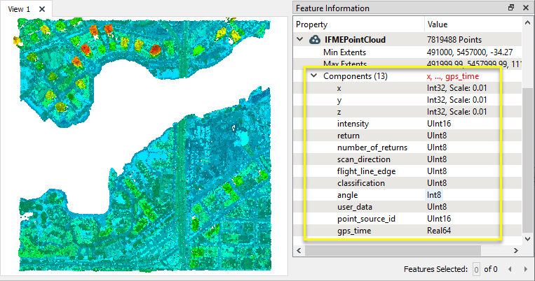

In this example, we are preparing a LiDAR point cloud dataset for use in creating a Minecraft world. The source dataset has a number of standard point cloud components. To prepare for Minecraft world building, we need to separate different classification types and add some new Minecraft-specific components.

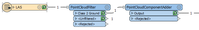

The point cloud is first routed into a PointCloudFilter, and then on to a PointCloudComponentAdder.

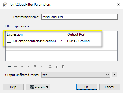

In the PointCloudFilter parameters dialog, we create one Expression/Output Port pair, which filters points with a classification value of 2 (meaning ground) into a single output feature, which is output via the defined Class 2 Ground output port.

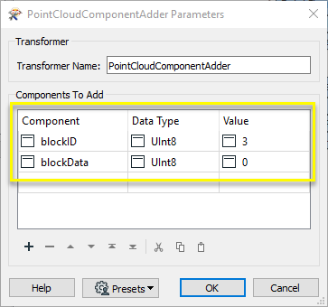

The filtered feature is then sent to the PointCloudComponentAdder, where in the parameters dialog we add two new custom components - blockID and blockData. Both are set to a Data Type of UInt8 and have constant values assigned to them - 3 and 0, respectively.

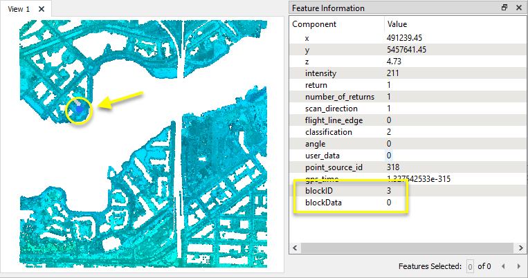

The output point cloud feature, as viewed here in the FME Data Inspector, contains only points of classification type 2. Those points now have the additional blockID and blockData components and values, and are passed along for further processing.
