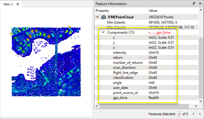

In this example, we have a large point cloud that has several components that we do not need. To optimize performance, we will remove the components we are not using.
Note that the original point cloud has thirteen components.
Each point in the point cloud has values for each component. The components we wish to keep are outlined in yellow.

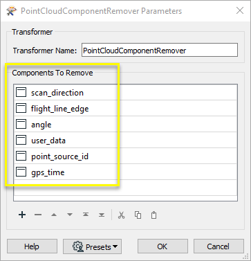

The point cloud is routed into a PointCloudComponentRemover.
In the parameters dialog, all unneeded components are added to the Components to Remove table.

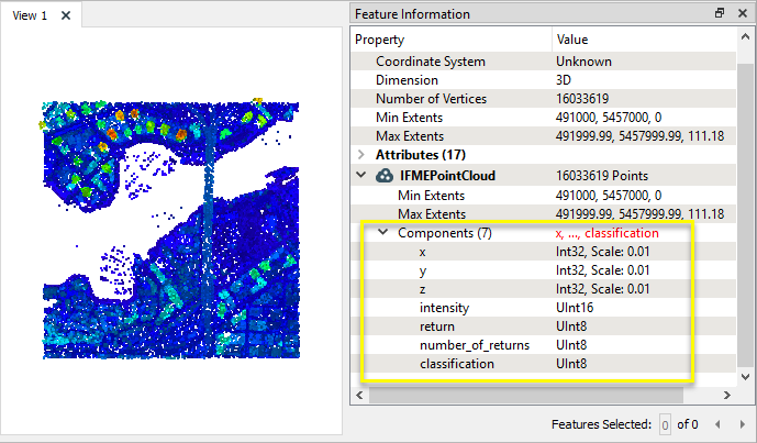

The output point cloud now has only 7 components.

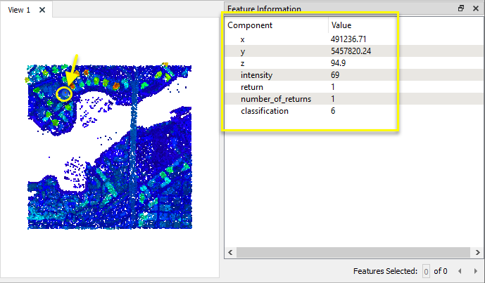

The points no longer have unneeded components and values.
