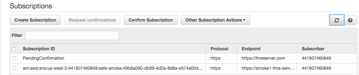

- Click Close. The new subscription appears under Subscriptions with “PendingConfirmation” as the Subscription ID.
- Complete the subscription process by clicking the Refresh button. “PendingConfirmation” is replaced with an identifier for your subscription.
Assuming you provided the correct endpoint and FME Server is running, the Amazon SNS publisher automatically confirms the subscription.
