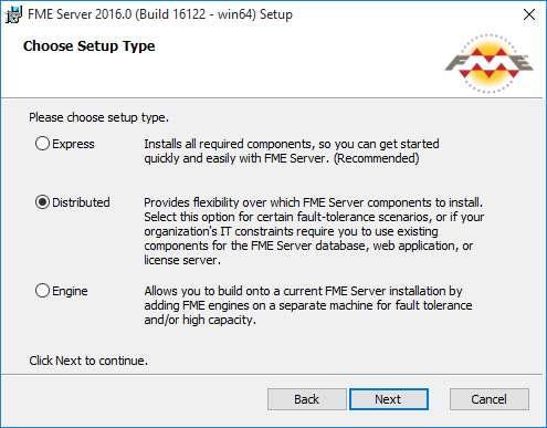

  1. Start the FME Server Installer.
  2. On the Choose Setup Type dialog, select the Distributed install option.

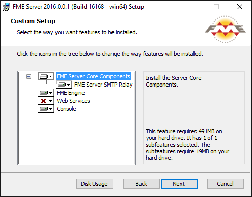

  3. On the Custom Setup dialog, select FME Server Core Components and FME Engine. Unselect Web Services. (Optionally, select Console. For more information, see FME Server Console.)
