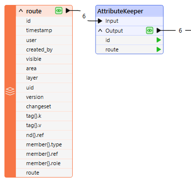

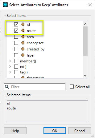

In this example, two attributes are selected from the pick list to keep.

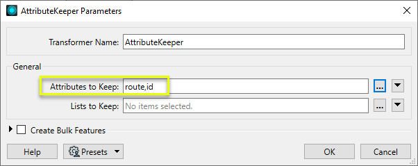

The Attributes to Keep parameter is populated with those choices.
As the features exit the transformer, all of the unwanted attributes have been removed, including all lists:

Attributes to Keep |
After the AttributeKeeper is connected, click the browse button to display the list dialog. Select the attributes that you want to keep on the feature. The unchecked attributes will be removed, except for any FME attributes. Format attributes will be removed, whether exposed or not. |
