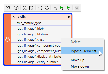

To expose the elements of a list attribute, right-click on one in a reader or transformer, and select Expose Elements.

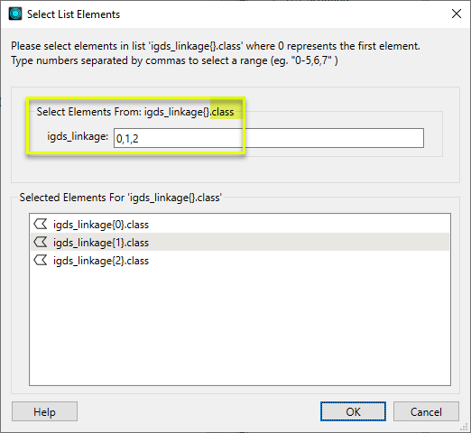

In the Select List Elements Dialog, enter the index integers of the elements you want to expose. Keep in mind that the first element of a list is always index integer 0.
The exposed elements are added to the attribute list. These qualified list elements are highlighted below:
