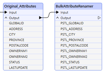

In this example, a prefix is added to all of the attributes.
The output attribute names are altered as requested.

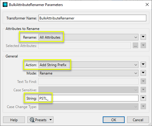

Rename |
Choose either All Attributes or Selected Attributes. |
Selected Attributes |
If you choose to rename Selected Attributes, this is enabled, along with an attribute picker. Select the attributes you want to rename. Note that internal FME attributes that have been exposed begin with βfme_β. Renaming these may produce unexpected results. |
Action |
Select the type of renaming you want to do to the attributes chosen above. Options include:
Mode |
Whether or not the original attribute names should be kept in addition to the new ones.
Text To Find |
When using the Regular Expression Replace or String Replace actions, enter the item you would like to replace here. The replacement string goes in the String parameter. If the Action parameter is set to Regular Expression Replace, the Regular Expression Editor will be available in the Text To Find parameter menu. |
Case Sensitive |
Indicate whether or not the comparison should be case-sensitive. |
String |
The character sequence to prepend, remove, append, or use as replacement string. |
Case Change Type |
For use with the Change Case action.
