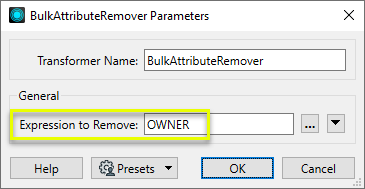

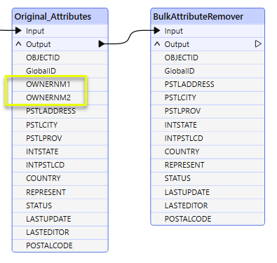

In this example, attributes containing the string “OWNER” are removed to anonymize the data.
Non-matching attributes pass through untouched, and the two attributes that do match are removed from the output.

Expression to Remove |
Enter a regular expression that specifies what string an attribute name needs to contain for it to be removed. For example, to remove AutoCAD format attributes from a feature, specify: ^autocad_.* Or to remove all attributes containing the string “INTL”, simply enter INTL. You can test expressions by using the Regular Expression Editor, accessed through the drop-down parameter menu. For more information on constructing expressions, see Regular Expression Editor. |
