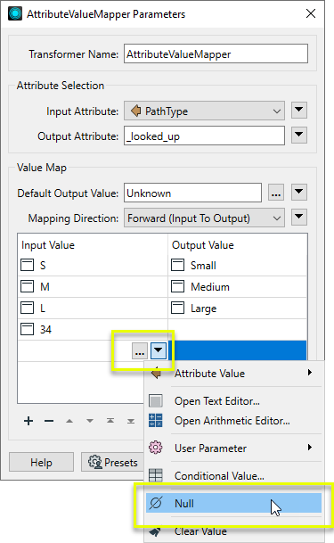

Support for Null, Missing, and Empty String Values
When mapping from input to output, there are three attribute values that are not supported by the Default Output Value parameter or the Value Map table. They are: missing, null, and empty string values. The exceptions are noted below.
It is possible to map or specify a default value of null by using the null constant, available on the parameter drop-down menu.
Further, it is possible to map a source value to a destination value of empty string, or to specify the empty string as the default value.
Note that if a missing or null value is specified as a destination value or default value via an attribute, it will be converted into an empty string.

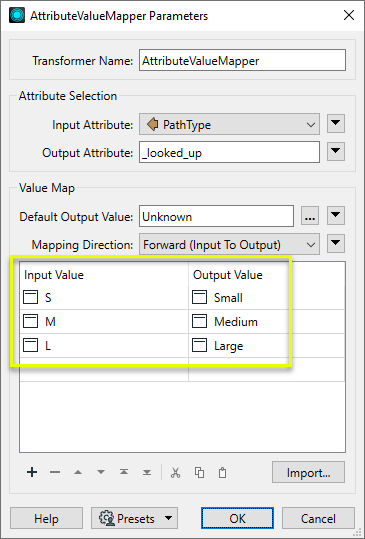

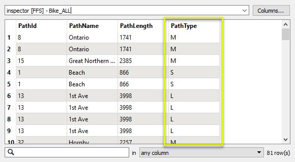

In this example, we want to map an attribute in our bike path dataset. The original data has an attribute called PathType, with values of S, M, and L.
The features are routed into an AttributeValueMapper.

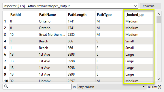

In the parameters dialog, we select PathType as the Input Attribute, keep the default Output Attribute name _looked_up, and assign a Default Output Value of Unknown (which will be used for any feature that has a PathType not found in our lookup table).
For each of our possible Input Attribute values, we create a value pair in the Value Map.
The output features now have a new attribute, _looked_up, containing the mapped values.

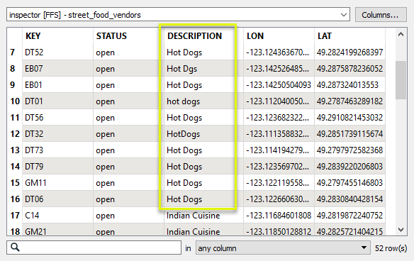

In this example, we have a dataset of food vendors, in which the DESCRIPTION attribute values have a number of errors and style differences such as capitalization. There are also some values that we want to combine into broader categories.

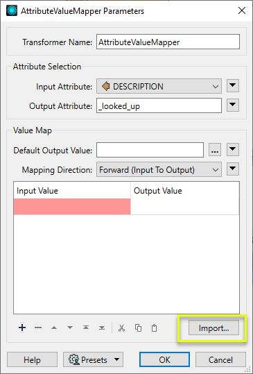

The features are routed into an AttributeValueMapper. In order to find all possible values in the dataset, we will use the Import wizard in the parameters dialog.
The first step is to select the dataset to import - choose the same dataset we want to clean up.

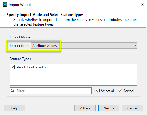

Note that on the second dialog - Specify Import Mode - we need to change the Import Mode to Attribute Values.

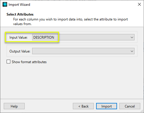

Next, on the Select Attributes dialog, we specify the Input Value as DESCRIPTION. We are not importing Output Values (as we might if loading a predefined value map), and so it is left blank. Click Import to finish.

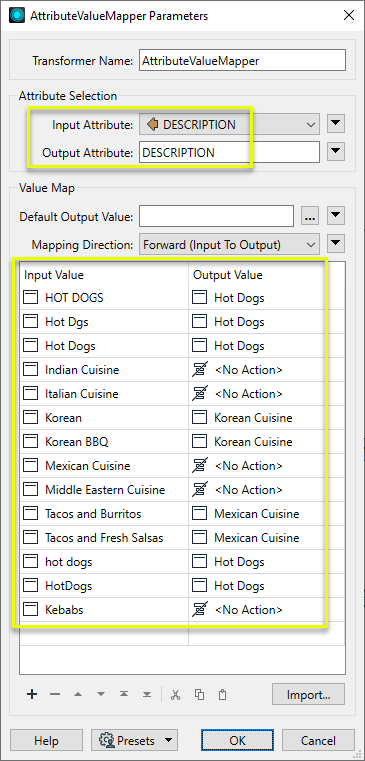

The dataset is scanned for all existing values, and they are loaded into the Value Map. Then we complete the Output Value side of the table. Note the following choices:
- All variations of Hot Dogs (hot dogs, HotDogs, HOT DOGS, and so forth) are mapped to Hot Dogs.
- Several values that are already in the desired form (Indian Cuisine, Italian Cuisine) have <No Action> assigned to them, and so will not be changed.
- Some related types are assigned a common name and so will be combined (Korean Cuisine, Mexican Cuisine).
Note that the Output Attribute is the same as the Input Attribute. This will result in the new values overwriting the original values (except for those denoted as <No Action>).

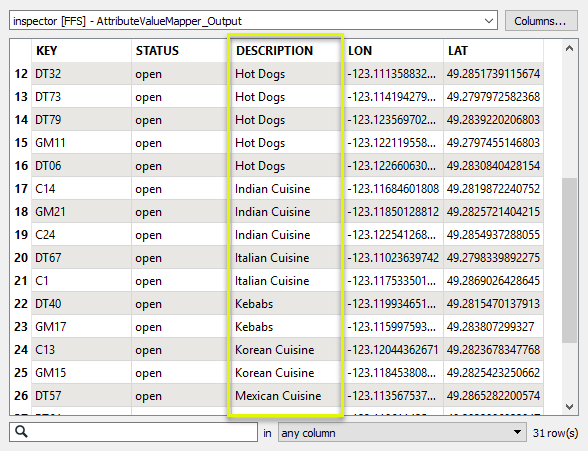

The cleaned up output features reflect the desired changes.
