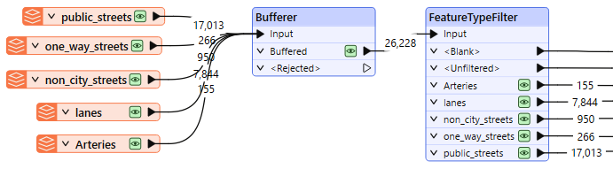

In this example, several datasets containing different types of street are to be buffered, but need to be handled separately after that operation.
One Bufferer per dataset would work, but a single Bufferer followed by a FeatureTypeFilter is more efficient.

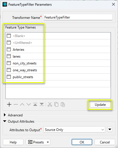

In the parameters dialog, Update was used to populate the list with available feature types. A named output port is created for each one.

An output port is created for each feature type specified in Feature Type Names.
This table specifies the features types to include as output ports.
The Update button refreshes the list based on connected upstream feature types.
Note that if connected features are disconnected, Update may remove previously included ports and their downstream connections.
