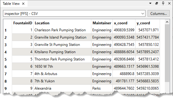

In this example, we have a CSV file containing locations of drinking fountains. We want to create point geometry from the coordinates.

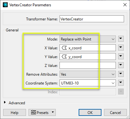

The features are routed into a VertexCreator.
In the parameters dialog, Mode is set to Replace with Point and the X and Y Values are set to the corresponding attributes. The appropriate coordinate system is specified.
Note that Mode > Add Point would also create point geometry in this case, but does not have the option of setting a coordinate system.
Remove Attributes is set to Yes, as they will no longer be needed once the geometry is created.

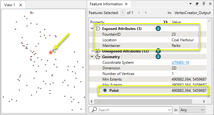

The output features have point geometry, and the specified coordinate attributes have been removed.
