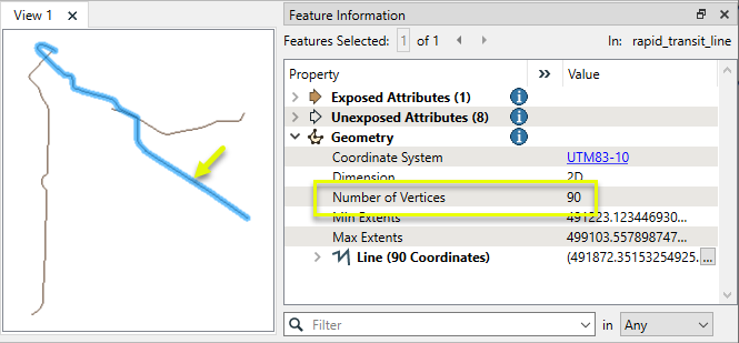

In this example, we have a set of rapid transit routes, and want to create points at the end of each feature.
The features are routed into a VertexRemover.

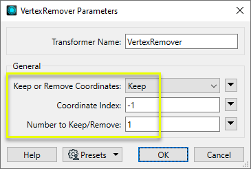

In the parameters dialog, Keep or Remove Coordinates is set to Keep. The Coordinate Index is -1 (representing the last vertex), and the Number to Keep/Remove is 1.

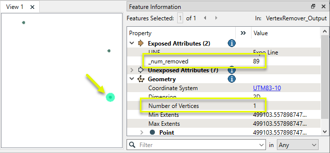

The output features’ geometry has been replaced with a single point, at the end of the feature. All other vertices have been removed.
Note that an attribute has been added, containing the number of vertices removed.
