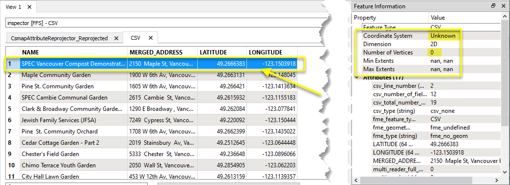

In this example, we have a CSV file containing Community Gardens, along with their address and latitude/longitude coordinates. The features have no geometry - the coordinates are stored as attribute values.
We want to add a second of coordinates, also as attributes, in an appropriate UTM coordinate system.

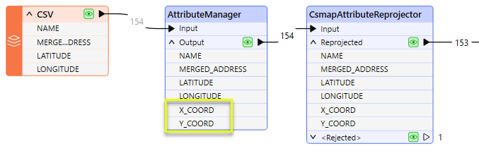

This will take two steps - first, the features are routed into an AttributeManager to create a copy of the coordinates, and then to a CsmapAttributeReprojector to reproject them. Note that one feature has been rejected as it had null coordinate values.

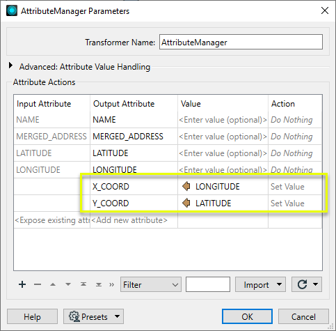

In the parameters dialog of the AttributeManager, we add the two new attributes X_COORD and Y_COORD, and copy the values from LONGITUDE and LATITUDE.

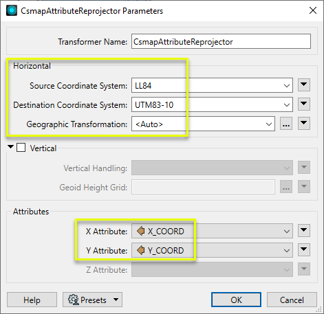

In the parameters dialog of the CsmapAttributeReprojector, we set the Source and Destination Coordinate Systems to LL84 and UTM83-10, respectively. Geographic Transformation is left as default, <Auto>.
As the data is 2D, Vertical Handling is not enabled.
The X Attribute and Y Attribute are mapped to the attributes we just added with the AttributeManager.

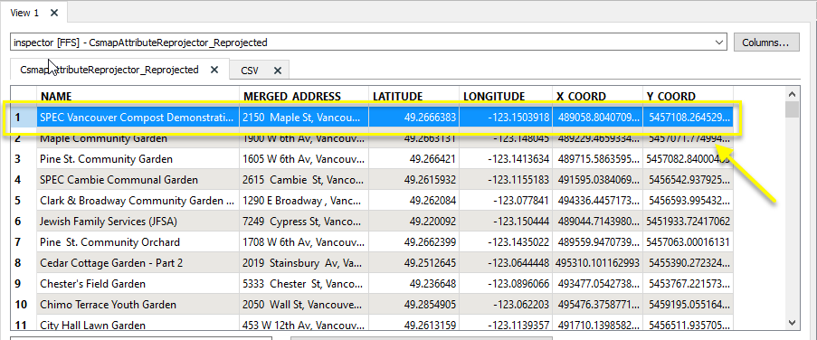

The output features still have no geometry, and now contain a second set of reprojected coordinates, for UTM Zone 10 NAD83.
