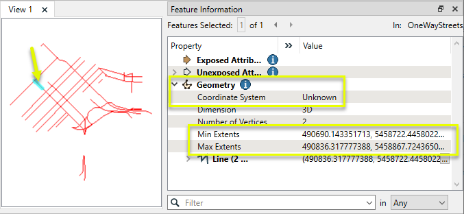

In this example, we have a DWG (CAD) file of one-way streets. Though DWG files can come with coordinate system information attached, this one does not have it. Note that the extents of the selected feature would be appropriate coordinates for a UTM coordinate system.

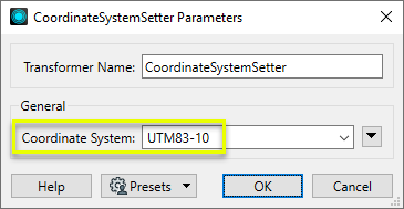

We do know that the data is in UTM83-10, and need to assign that coordinate system to the data without modifying the feature geometry.
The features are routed into a CoordinateSystemSetter.
In the parameters dialog, Coordinate System is set to UTM83-10.
The output features now know their coordinate system, and the coordinates themselves have not been modified.
