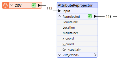

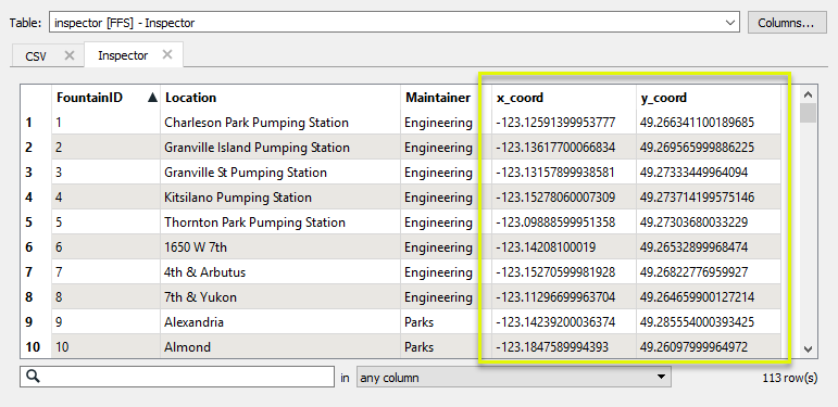

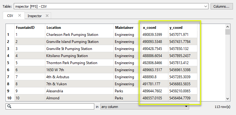

In this example, we start with a CSV file of drinking fountain locations. A CSV dataset has no geometry, but it does contain coordinates for the fountains, in a UTM projection.
The CSV features are routed into an AttributeReprojector.

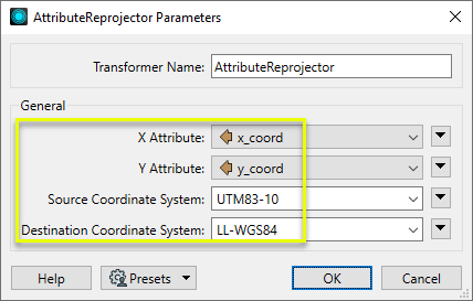

In the parameters dialog, the x and y attributes containing the coordinates are specified accordingly, the source coordinate system entered (as UTM83-10), and the new destination coordinate system chosen (LL-WGS84).
The new coordinates are calculated and replace the existing attribute values. The transformer does not create geometry, it only supplies values.

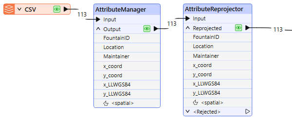

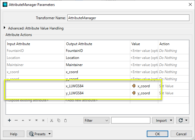

In this example, we start with a CSV file of drinking fountain locations, which has no geometry. It contains coordinates for the fountains, in a UTM projection. We want to add an additional coordinate system’s coordinates to it, to provide options for users who may not have access to software that will reproject it for them.
The CSV features are routed into an AttributeManager, and then to the AttributeReprojector.
In the AttributeManager, we add two new attributes, named x_LLWGS84 and y_LLWGS84. Using the Attribute Value column, we copy the current x and y coordinates (still in UTM) from the x_coord and y_coord attributes.

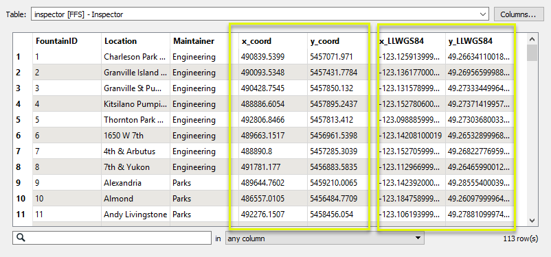

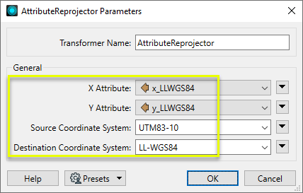

In the AttributeReprojector parameters dialog, the x and y attributes are set to the new (copied) attributes, and the Source and Destination coordinate systems chosen.
The output now contains both sets of coordinates - the original UTM and new LL-WGS84.

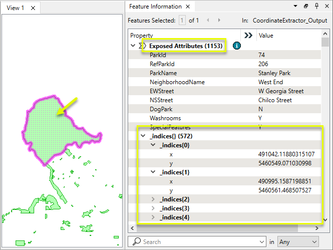

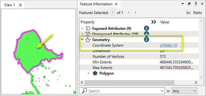

In this example, we have a set of park polygons, in a UTM coordinate system. We want to generate coordinates in an alternate coordinate system and keep them on the park polygons as an attribute.
To do this, we will use a CoordinateExtractor to extract the polygon vertices into a list attribute, and then reproject that list with an AttributeReprojector.
In the parameters dialog of the CoordinateExtractor, note that All Coordinates will be stored in a list attribute named _indices.
Polygons output from the CoordinateExtractor have a list attribute containing their coordinates. Note that each list item has an individual x and y coordinate.

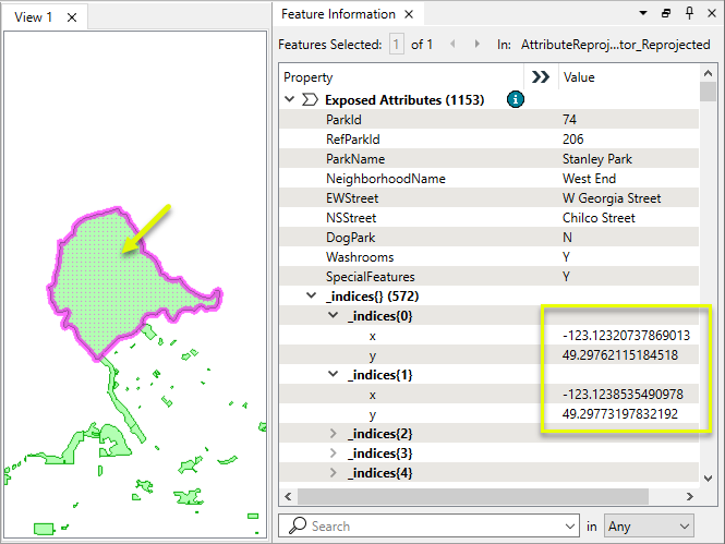

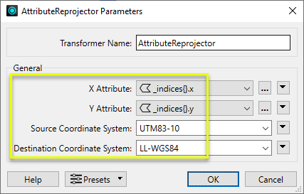

In the parameters dialog of the AttributeReprojector, X and Y Attribute are set to the corresponding list item. The coordinates will be reprojected to LL_WGS84.
The reprojected coordinates have replaced the input list attribute values.
