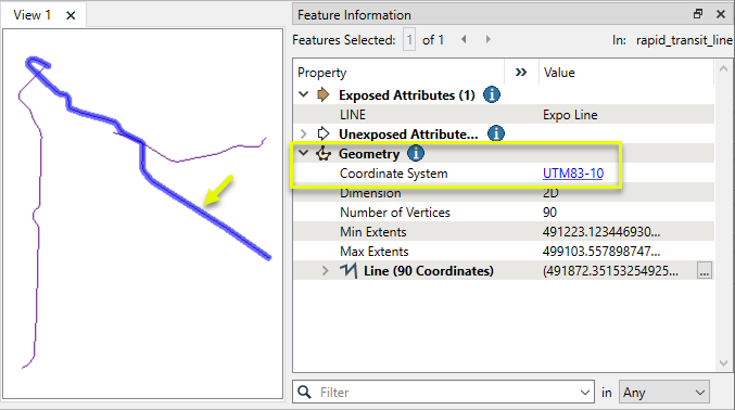

In this example, we have a shapefile of transit lines. Note that the FME Data Inspector knows what the coordinate system is and displays it, but that information is not readily accessible in attribute form.
The transit lines are routed into a CoordinateSystemExtractor.

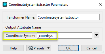

In the parameters dialog, we keep the default Coordinate System Attribute name of _coordsys.

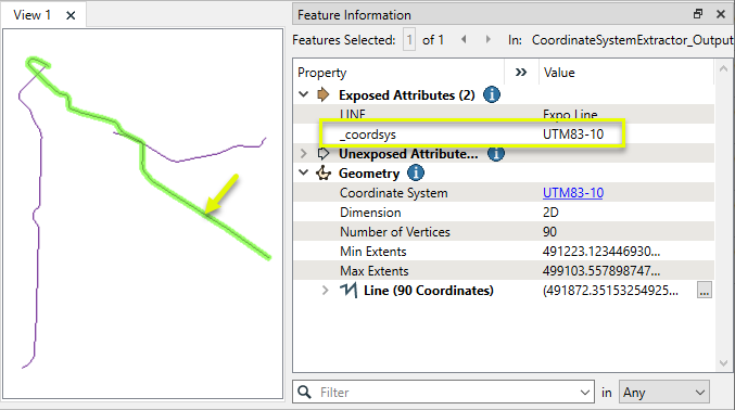

The output features now have the coordinate system name stored as a new attribute.
