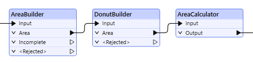

The example below shows how a custom transformer can replace multiple transformers. Three transformers have been placed on the main canvas: one to create polygons, one to turn them into donuts, and one to measure the created features.
A custom transformer combines the three transformers into one:

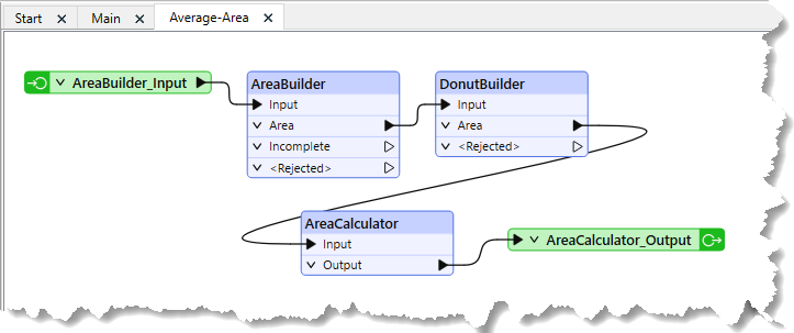

The original transformers are moved to a separate tab on the workspace canvas. The input and output ports on the custom transformer are represented by the green objects.
