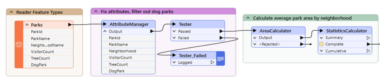

  • In this workspace (partially shown), bookmarks define where specific tasks are performed so they can be referenced more easily:

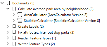

Viewing Bookmarks in the Navigator
Bookmark names are listed as folders in the Navigator. Expand the bookmark name to view its contents:
