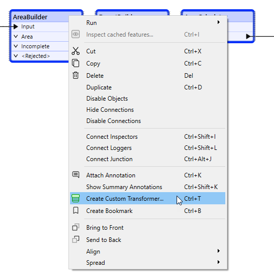

  2. Select a group of transformers: click and hold the left mouse button, and drag a box around the transformers. Release the mouse button.
  3. Press Ctrl + T, or right-click and select Create Custom Transformer.

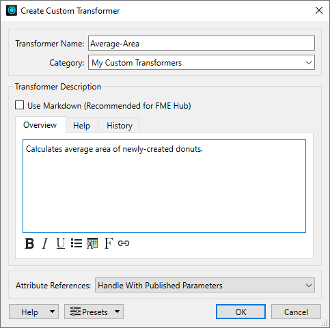

  4. In the Create Custom Transformer dialog, enter parameters for the custom transformer.
  5. Creating Category Names: In the Category field, you can choose an existing category in which to store the transformer; however, you can also enter your own category name. The category will be added to the Transformer Gallery. Note that you will have to restart FME Workbench to see the new category.
    You can also enter other optional information, including a description. For information about entering an extended description, see Workspace Parameters.

    • Handle With Published Parameters: FME automatically creates published parameters, and sets their values, for each attribute used in the custom transformer. These attributes are passed into the input port of the custom transformer. This option is recommended because it prevents you from having to define input attributes each time the custom transformer is reused in another workspace.
    • Advanced - Fix Manually: FME does not create any published parameters for attributes that are required by the custom transformer. To ensure the custom transformer is equipped with any attributes it needs to perform its function, you must add them manually. For more information, see:

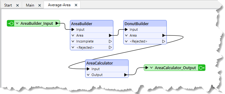

  6. Click OK. In this example, FME Workbench opens a new tab named Average-Area and the original group of transformers is shown on the canvas.
The input and output (if included) arrows are for reference only, to reflect the input/output to the custom transformer in the main workspace.
  • The original group of transformers is replaced with the new custom transformer in the main workspace:
  • Note  You cannot include any reader or writer feature types in a custom transformer.

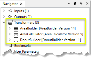

    When the custom transformer workspace tab is selected, the Navigator lists the transformers (and their attributes) that are part of the custom transformer.
    In the main workspace, the custom transformers, and their own parameters, are listed in the Navigator (much like any other transformer), except they appear as green icons:
