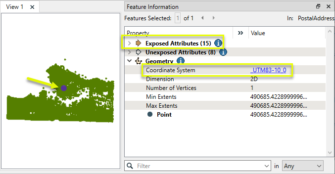

In this example, we have a geodatabase containing address points. Note that the point features have 15 exposed attributes, and are in a UTM coordinate system. We want to extract the coordinates of each point into attributes for use elsewhere.
The address points are routed into a CoordinateExtractor.

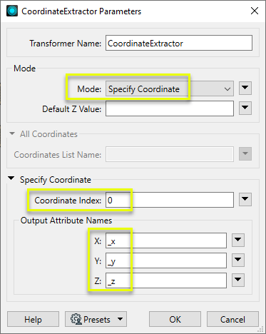

In the parameters dialog, Mode is set to Specify Coordinate. The Coordinate Index default is zero (0), the first one, which is correct. Default names are also provided for the X, Y, and Z output attributes.
Note that although Mode > All Coordinates would also return just one set of coordinates per point, and wouldn’t require setting a Coordinate Index number, they would be added as a list attribute, potentially requiring additional transformers to work with.
The output features have added attributes - _x, _y, and _z. Note that the coordinate values are in meters due to the UTM coordinate system.

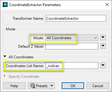

In the parameters dialog, Mode is set to All Coordinates. A default name is provided for the Coordinates List Name - _indices.
The output features have an added list attribute named _indices containing coordinates for each vertex of the polygon.

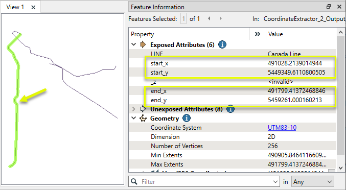

In this example, we want to retrieve the coordinates of the first and last points of these transit lines. Note that the original features have nine attributes.
The features are routed through two CoordinateExtractors, one to extract the first point and one to extract the last.

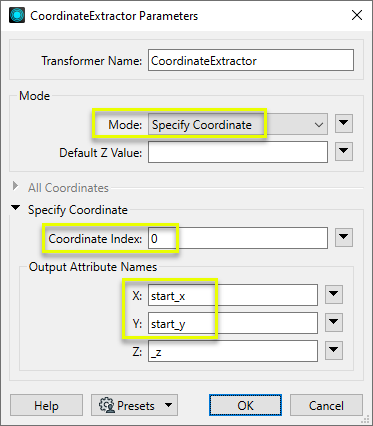

In the parameters dialog of the first CoordinateExtractor, Mode is set to Specify Coordinate and Coordinate Index is set to zero (0), indicating the first vertex.
The X and Y Attribute names are edited to start_x and start_y.

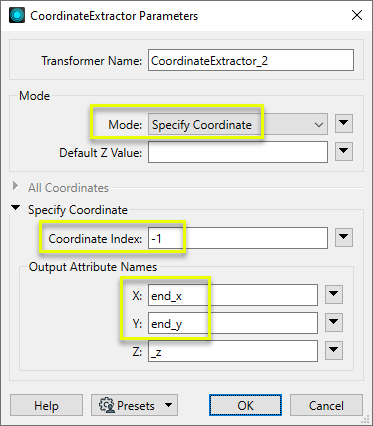

Similarly, in the parameters dialog of the second CoordinateExtractor, Coordinate Index is set to -1, indicating the last vertex. X and Y Attribute are set as end_x and end_y.
The output features have added attributes containing the requested coordinate values.
