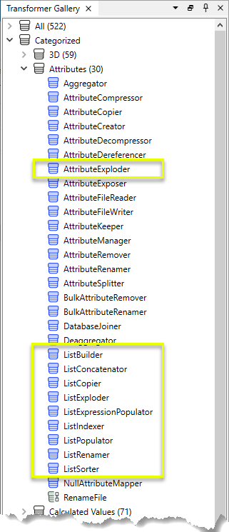

List transformers allow you to work with list attributes.
See the Attributes category in the Transformer Gallery:
