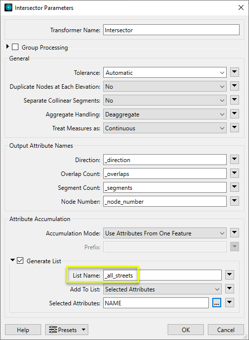

Set up a workspace that routes all the street centerlines into an Intersector transformer. Adjust the parameters of the Intersector to supply a list name (for example, all_streets).

To turn the list of NAMEs into a single string, add a ListConcatenator
 transformer and run the NODE features into it. Then set up the ListConcatenator's
 parameters so that it would put the contents of the all_streets{}.NAME
 list together, separated by commas, into the destination attribute.
Route the output of the ListConcatenator to an output file, and ensure that the destination attribute was routed to an attribute in the output. After running the translation, you'd have the desired result.

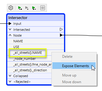

Expose Elements
Note that you can also access the individual street names by "exposing"
 some elements of your list: right-click on the attribute unqualified
 list name (in our example,  all_streets{}.NAME)
 and select Expose Elements.
In the Select List Elements dialog, enter the number of elements to expose. (The disadvantage to this approach is that you need to know ahead of time how many list elements you want to work with.)
