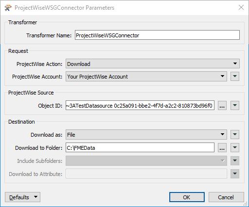

In this example, the ProjectWiseWSGConnector is used to download a Bentley MicroStation Design document from ProjectWise. We start by creating a valid web connection to a WSG deployment (which can be done right in the ProjectWise Account parameter) and browsing to the Design document, which retrieves the Object ID for the document. Finally, we choose to download as a File and select a destination for the download.

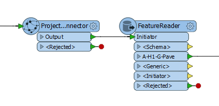

A FeatureReader is added to read the newly downloaded dataset. Here, the A-H1-G-Pave feature type will be further processed elsewhere in the workspace.
By executing the download here in the workspace, the Design document will be refreshed every time the workspace is run.

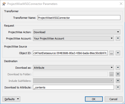

In this example, the ProjectWiseWSGConnector is used to download a raster from ProjectWise into an attribute.

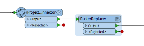

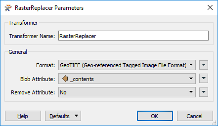

The document is read from ProjectWise and the contents stored as a blob attribute. Then a RasterReplacer is used to interpret the blob into a usable raster format.
The combination of these two transformers avoids having to download the image to local storage and re-read it. A similar technique can be used for point cloud files, using the PointCloudReplacer transformer.
