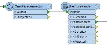

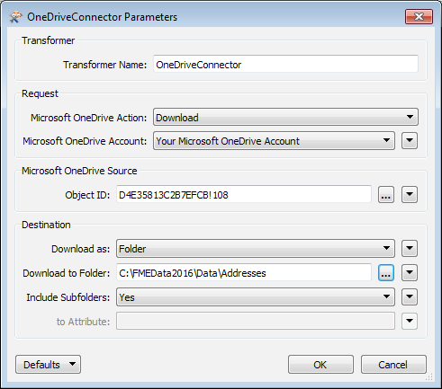

In this example, the OneDriveConnector is used to download an Esri Geodatabase from Microsoft OneDrive. After creating a valid web connection to a Microsoft OneDrive account (which can be done right in the Microsoft OneDrive Account parameter), and browsing to the geodatabase folder, the Object ID is retrieved, and a destination for the download is selected.
A FeatureReader is added to read the newly downloaded dataset. Here, the PostalAddress feature type will be further processed elsewhere in the workspace.
By executing the download here in the workspace, the geodatabase will be refreshed every time the workspace is run.

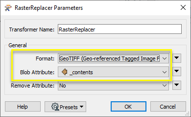

In this example portion of a workspace, the OneDriveConnector is used to download a raster orthoimage from Microsoft OneDrive into an attribute.
The file is read from Microsoft OneDrive, and the contents stored as a blob attribute. Then a RasterReplacer is used to interpret the blob into a usable raster format.
The combination of these two transformers avoids having to download the image to local storage and re-read it. A similar technique can be used for point cloud files, using the PointCloudReplacer transformer.

Microsoft OneDrive Source
Object ID |
The Microsoft OneDrive ID of the file/folder to download. If valid credentials have been provided as a web connection, you may browse to a location. |
Destination
| Download as |
Select whether to store the downloaded data in a File, Folder or Attribute.
| Download to Folder | Specify the path to the folder that will store the downloaded file. Valid for Download as File or Folder. |
| Include Subfolders | Choose whether to download subfolders of the Microsoft OneDrive Source or not. Valid for Download as Folder only. |
| Download to Attribute |
Specify the attribute that will store the contents of the downloaded file. Valid for Download as Attribute only. Note: FME will attempt to convert the attribute's contents to a UTF-8 string. If this fails, the attribute's contents will be created as raw binary. To ensure that the original bytes are always preserved and never converted to UTF-8, use Download as File instead. |
