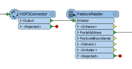

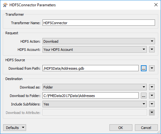

In this example, the HDFSConnector is used to download an Esri Geodatabase from HDFS. After creating a valid web connection to an HDFS account (which can be done right in the HDFS Account parameter), and browsing to the geodatabase folder, the HDFS path is retrieved, and a destination for the download is selected.
A FeatureReader is added to read the newly downloaded dataset. Here, the PostalAddress feature type will be further processed elsewhere in the workspace.
By executing the download here in the workspace, the geodatabase will be refreshed every time the workspace is run.

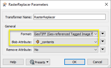

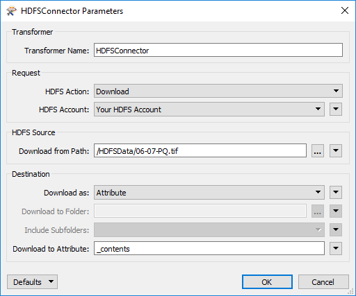

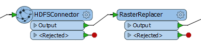

In this example portion of a workspace, the HDFSConnector is used to download a raster orthoimage from HDFS into an attribute.
The file is read from HDFS, and the contents stored as a blob attribute. Then a RasterReplacer is used to interpret the blob into a usable raster format.
The combination of these two transformers avoids having to download the image to local storage and re-read it. A similar technique can be used for point cloud files, using the PointCloudReplacer transformer.
