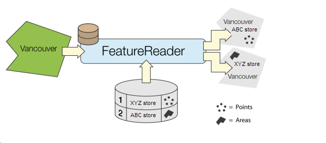

FeatureReader
Reads features from any FME-supported format. A complete read is done for each feature that enters the Initiator port. The features resulting from the read are output either through named output ports or through the generic output port.
The features read can be constrained by specifying a WHERE clause or a spatial filter for formats that support them. Most reader settings and constraints can be configured dynamically from attribute values on the input features.
Additionally, a schema feature representing the feature type definition is output for each encountered feature type. The schema features can be used to configure feature type definitions for dynamic writing.
