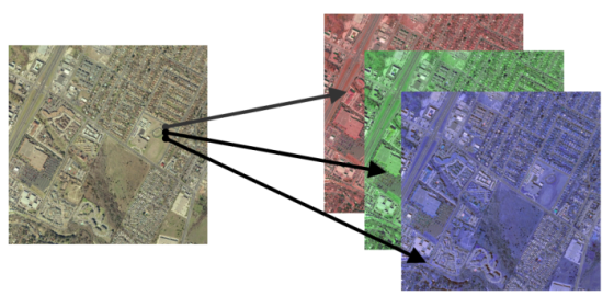

Separates bands or unique band and palette combinations, and outputs either individual raster features or a single new raster feature containing all combinations.
- Isolating bands or palettes to meet format or processing requirements.
The RasterBandSeparator receives raster features and separates their bands and palettes into individual output raster features.
Raster features may be split by band, band and palette, or palette.
Separating by Band Only will produce multiple output features, one for each band.
Separating by Band and Palette will also produce multiple output features, one for every unique band and palette combination.
Separating by Palette Only will produce a single output feature per input feature, containing bands for every unique band and palette combination.

In this example, we will separate a multi-band orthoimage into its component bands.
Note that the original raster has three bands - red, green, and blue.
