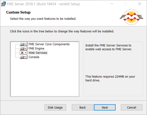

- On the Choose Setup Type dialog, select the Distributed/Fault Tolerant install option.
- On the Custom Setup dialog, select FME Server Core Components and FME Engine. Unselect Web Services. (Optionally, select Console. For more information, see FME Server Console.)

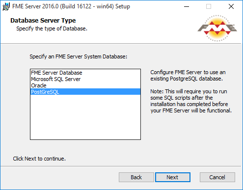

- On the Database Server Type dialog, specify the type of database for the FME Server Database. For more information, see Provide a Database Server.
- On the Database Server Parameters dialog, specify the connection parameters for the FME Server Database.
