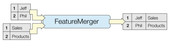

Moves the attributes/geometry from one feature (or multiple features) to another feature. Features that contain the desired attributes/geometry are connected through the Supplier port, and the features that will receive the attributes/geometry are connected through the Requestor port.
When a Requestor finds a Supplier, the attributes from the Supplier are merged with the Requestor. If the Requestor already had an attribute that the Supplier also had, the Requestor's original value for that attribute is preserved. A single Supplier may be used by many Requestors.
Any merged geometry preserves arcs, ellipses and text.
Requestor features are joined to Supplier features when the expressions specified in the Join On parameter ALL have the same value for both the requestor and supplier.
