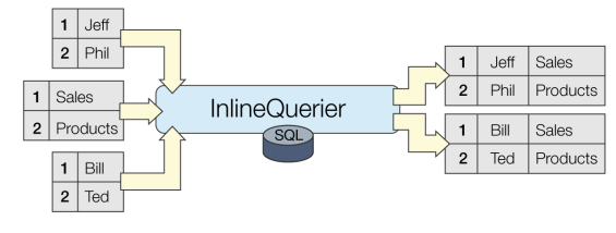

Executes SQL queries against a temporary database consisting of tables created from incoming features, returning the results as new features.
Any number of tables can be created, and each will be assigned an input port. Any features can be routed to that input port as long as they supply values for each column defined for the table. Similarly, any number of queries can be specified, and each is assigned an output port through which the features which result from that query will be routed. The queries can involve any and all tables and columns defined in the input. In particular, multi-way joins can be executed, advanced SQL operations involving nested Select statements and advanced predicates can be used, and the input tables can be used by multiple queries.
This transformer is particularly useful to SQL-enable input streams of features coming from sources that have no SQL ability, as well as to perform multi-way joins across streams.
