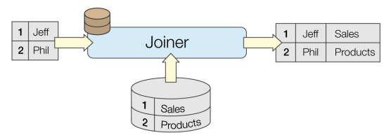

The Joiner queries an external table to retrieve attributes associated with a feature. One or more feature attributes are joined to one or more columns in a table in the database, and the values from the matching table row(s) are added as feature attributes.
The _matched_records attribute specifies how many records in the database the feature matched to.
