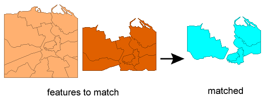

All features matching another feature are output to the Matched port.
A single copy of each set of matched features is sent to the SingleMatched port. The attributes on these features will be merged onto the single output feature. So, Matcher is capable of doing multi-feature merging with geometry as the key. This complements FeatureMerger, which only accepts attributes, and not geometries, as keys.
All non-matching features are sent to the NotMatched port.
The Match Geometry parameter controls whether 2D or 3D (or NO) geometry must be the same before a match is declared. FULL makes sure 3D, measures, and Geometry Traits all match.
