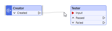

Manual Connect
You can manually connect transformers to a feature type, attribute, or another transformer by dragging the output arrow to the desired place. When the connection is placed, both arrows will turn black.
You can also connect a transformer by dragging it close to a connection port until you see a highlight, using the green triangle as a guide. The connection is set when you release the mouse button.
Note  If there is more than one port to connect, a dialog prompts you to set the connection.
You can then manually connect output ports to their destinations.
