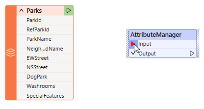

Click on any output port to be connected. A green circle highlights the port:
Move the cursor directly over the input destination port and click to set the connection.
To connect multiple ports, press the Ctrl key before you establish the first connection, then click additional input ports.
