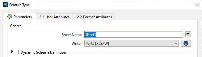

Just like Writers, feature types have their own set of parameters that control how that feature type (layer/table) is being written. These parameters apply only to a single feature type, whereas a Writer parameter applies to all feature types. Writer Feature Type parameters provide a degree of individual control over writing different layers or tables.
You can rename the feature type by simply clicking in the Feature Type name field and typing a new name.

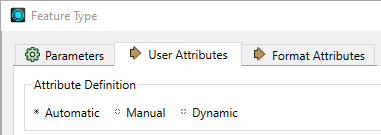

Attributes can be defined in three ways: Automatic, Manual, or Dynamic.
The default option is Automatic.

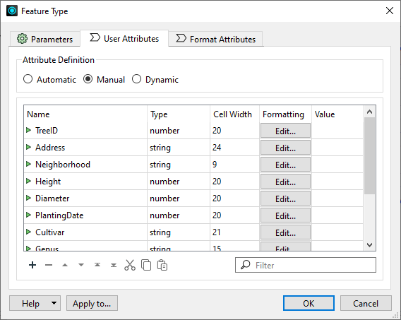

Manual User Attribute Definitions
On the FME Workbench canvas, the feature type indicates attributes with user-defined defined values. In this example, there are three:
Automatic User Attribute Definitions
When Schema Definition is Automatic, FME Workbench automatically copies all of the incoming feature type's attributes, after any attributes are created or removed by transformers, and defines the list of attributes from this copy.
When Automatic is selected, the attribute definition fields are disabled, and you cannot edit them.

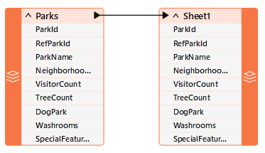

What makes the definitions automatic is the action that occurs when a Reader feature type or transformer is connected:
Notice that all of the attributes defined on the Reader feature type are now copied over to the Writer feature type automatically.
Because this operates automatically, if the Reader feature type is removed, and another one is connected, the list of attributes on the Writer feature type will be immediately updated to match. Or, if a second Reader feature type is connected, then the list of attributes updates to become a union of the two types:
